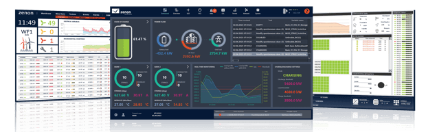

      zenon's built-in energy application sets provide a reliable toolbox for developing sample solutions. These features incorporate an extensive catalog of project and component templates. You can also use the provided application demo as a starting point for your engineering process.
      • Content_full_2560x800px_Efficient_engineering_2
        Various templates are provided in zenon for rapid application development

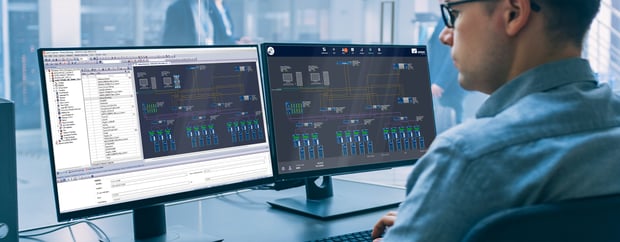

          Using zenon helps you optimize your process simulation. You can switch drivers to simulation mode, keep variables on static values, or animate variables dynamically — for instance, on the basis of a soft PLC script, which can simulate even complex process behavior.
