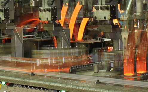

Sklostroj manufactures what are known as IS-machines (individual section).  These machines have individual sections arranged side by side, each of which works separately to press hot glass into shape before cooling it down. This process can be employed to produce bottles and glasses of almost any shape and size.
Data is collected permanently in automated production, recording the pressure in the machines, the temperature, and similar variables, for example. Once collected, the data is used to monitor production and, if used correctly, can significantly increase operational efficiency. Each of these numbers corresponds to a variable. Approximately 23,850 variables are captured per cycle in each section of the machines at Sklostroj. In the case of a standard machine with twelve sections, this equates to a total of approximately 286,200 variables.
